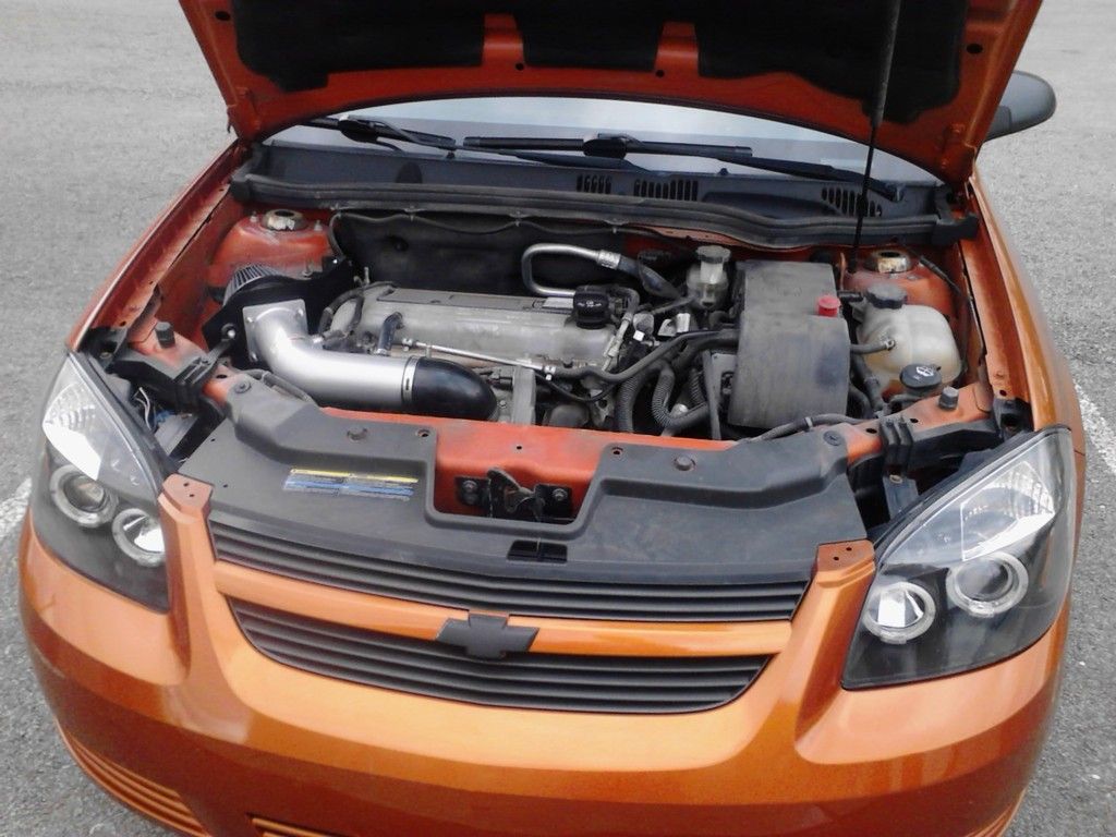

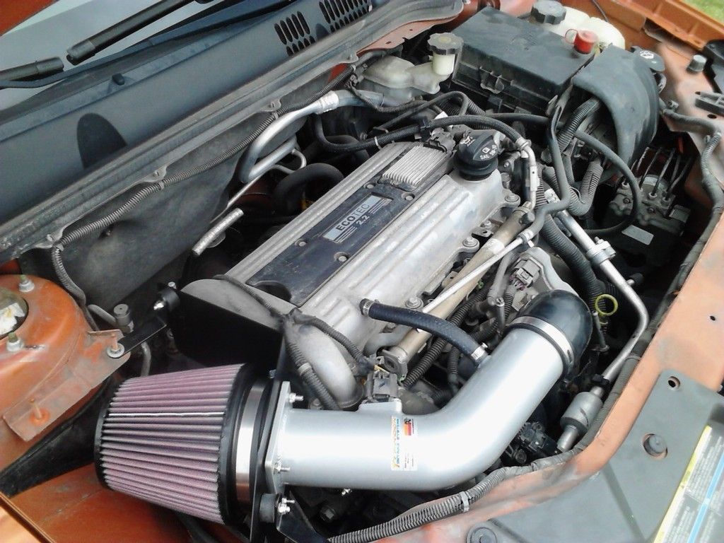

Since this is a Intake thread I was excited to share that I finally got my K&N 69-4515TS Typhoon air intake system installed. Sounds and looks great! Easy installation I already notice the improvement when I took her for a ride today.

I can't imagine that heat shield makes that good a seal with the hood once it's shut. You're probably getting some heat soak in there. It wouldn't hurt your MPGs though.
